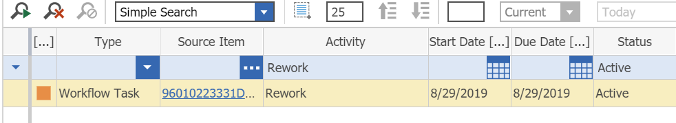

      Hi Phinnix
      It works but still I can see the subflow has the active task n In Basket with activity Delegate and Refuse (actual subflow is already closed but task from subflow is still active). How to make it disappear from user In Basket

        Hey Gopikrishnan,
        Sorry about the delay in the response. I'm not sure why that step would have stayed open the only time we've experienced this issue is when we have two subworkflows running parallel within a subworkflow of a main workflow. If you are trying to run your parallel paths like this you will need a separate solution. I currently have a user testing a solution for the above scenario and if it works I'll link to my forums post where I'll post the solution to this. outside of this being the case I have a few questions.
        Is this Rework step the autostep that you are assigning your path from in prep for exiting the subworkflow?
        If it is. Is it also the an end step of the subworkflow?
        If it's not it might need to be.
        Where does it go once it leaves your subworkflow?
        Also screenshots of the workflow would help so I can see where and what is getting stuck.
