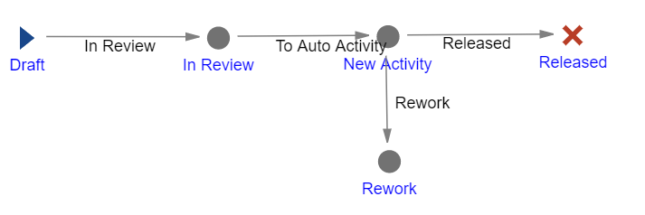

Main Workflow
In Review has Parallel Activity (Automatic Activity)

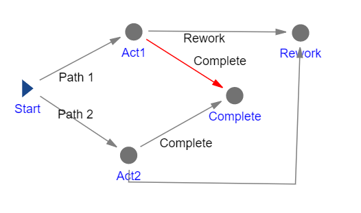

Sub Workflow
Complete is Automatic Activity and Wait for all inputs is selected and End Activity
Rework is not Automatic Activity and Wait for all inputs is not selected and End Activity
Server Events is attached to Complete and Rework Activity

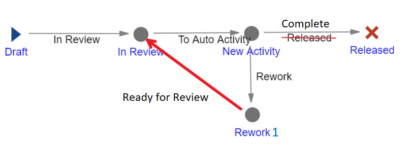

So based on your In Basket and your workflow this is what I think is happening. I think it is making it to the Rework on the main workflow but appears to be in the subflow because the activities are the same name. Can you rename the Rework on the main workflow to Rework1 just to test this hypothesis?
If the Activity in the In Basket is Rework1 then it's at the correct step if not then it's not making it there this can be changed back after we determine which step it is at.Also another reason I think it's getting to the correct step is the Rework step on the main workflow doesn't have any paths off of it so in that case it would only offer to delegate or refuse. I suggest adding a path back to In Review so that after the Rework on the Main workflow is complete it can be reviewed again. adding this path would be another good test to see if everything is working as you would then have the voting options delegate, refuse, and in the below example Ready for Review.
Lastly the path coming off of New Activity and going to Released needs to be the same name as the step that would send it there so for the method to work you will need to change the path from Released to Complete or the Activity in the subflow would need to be changed from Complete to Released. If the path and the end activity don't match you will get the "Not a single Item" error.Main workflow changes:
