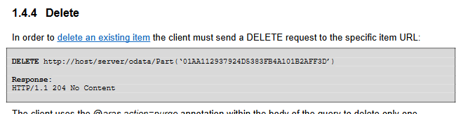

I tried to delete ItemType by following the Document about RESTful API in Aras.
For example, PostMan was called as below (DELETE) localhost/.../exItemType ('abcde')
If you call it url
A 405.0 - Method Not Allowed error message is returned.

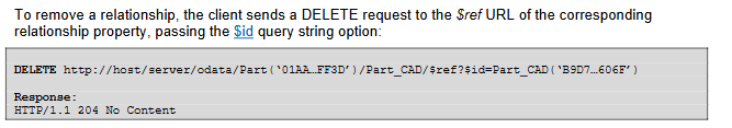

Additionally, I tried to remove the RelationshipShip for itemType, but the same error occurred.
Relationship remove was also carried out according to Document's method.
localhost/.../$ref
This also returns an error of 405.
How can I use RESTful to remove itemType?
  • additionally,
    access = Default Access / Can Add = admin , UserToken = admin Token
    That is, default Access, and it was done as admin
  • The second url is incorrectly written.
    localhost/.../exItemType ('abcde')/exItemFile/$ref?$id=exItemFile('bcdef')
    I sent the call as above.
