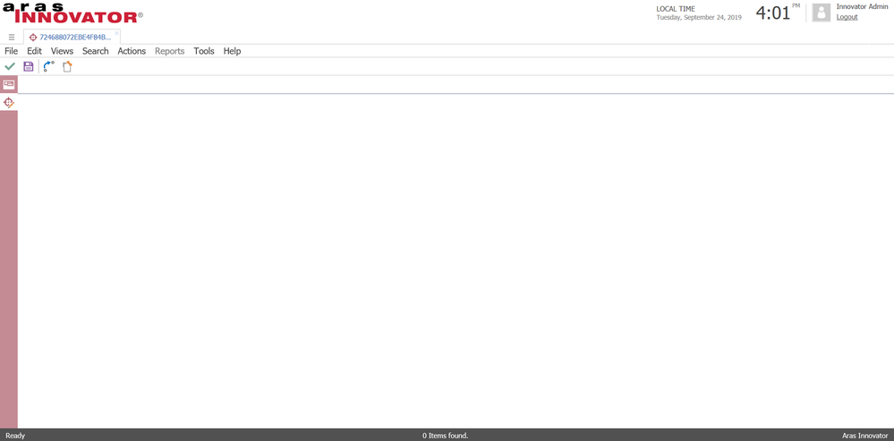

    • Henry_Tu's avatar
      Henry_Tu
      Hello Chris,
      I have successfully installed Requirements Engineering 11.0 R1. But I encountered another problem, Editor Interface is completely pure white. Picture attached below.
      Please to help me.
      Thanks,
      Henry Tu
  • Hello,
    I think the problem is that the Item Type tp_Applications doesn't exist yet. You can create it like this:
    TOC -> List -> New Item -> tp_Applictions (ID Item)
    You should download REQ11R1 and read file RE\11.0.222\Imports\RE\Import\Fixes\tp_Applications.xml.
    You edit file tp_Applications, replace id >> ID Item in line below:
     <Item type="List" id="4D54789248344C9AAC2E88A47CD93158" action="edit">
    <source_id keyed_name="tp_Applications" type="List">4D54789248344C9AAC2E88A47CD93158</source_id>
    Then, you will manual install Import Tool.
    Good luck,
    Henry Tu
