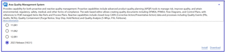

I am unable to download the correct QMS 2023 package through ArasUpdate Tool. Please help. Note: Looks like Process Quality Binding(PQB) package gets downloaded instead of QMS.38Views0likes2CommentsQuality Module Install error
