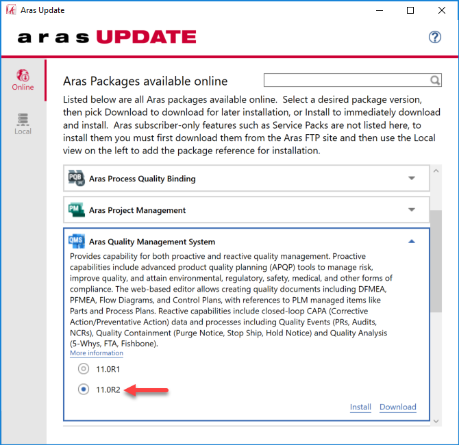

      Does this mean I can test the QMS without a subscription? Ive installed and run the updater but dont see the quality management tab in innovator
      • christopher_gillis's avatar
        christopher_gillis
        Hi Duncan,
        Yes, you should be able to test QMS without a subscription. After running the install, you should see the new ItemTypes in the TOC under Quality Management
        Could you let us know what version of Aras Innovator you are using? The most recent publicly available release would be 11.0 SP12. If you're using that version, could you also confirm that you've installed the 11.0R2 version of QMS?
