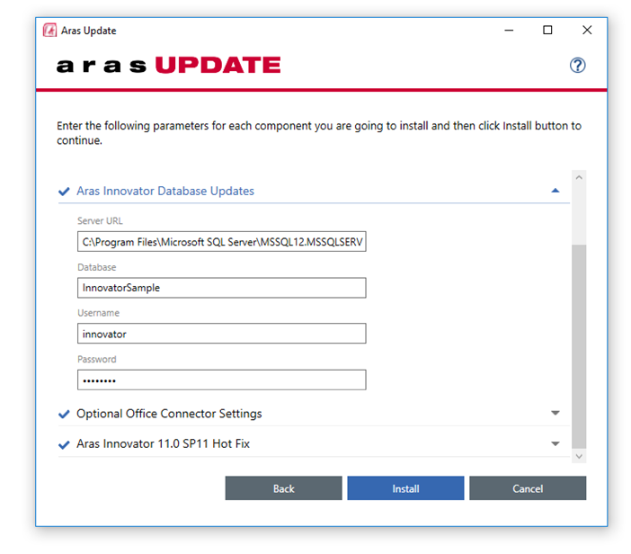

Found the QMS installer now, but struggling with the database updates.
I used the generic details provided in the installation guide. unsure what my server URL and Database would be?

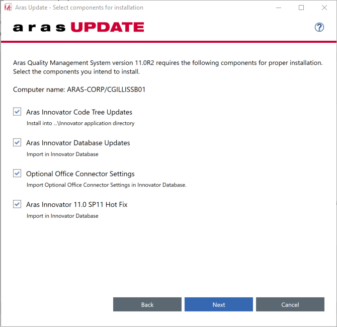

After selecting the 11.0 R2 version, you should check that you want to install all the features available for this application.

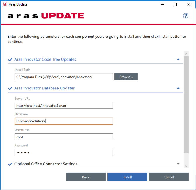

After that you can click next until you get to the screen from your reply.
You can find a description of what each of these parameters are as well as what the default value is for a standard install of Aras Innovator in the list below.
