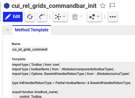

Hi community, since a few releases Aras added a "Template" item selector to the Method ItemType. Release 2023 already contained the new property, but didn´t use it yet. It was also hardly used in I30. But there is much more going on since I31. What do we need to know about Method Templates?Solved153Views1like3CommentsHow to use Visual Studio Code 2022 for Coding Methods
