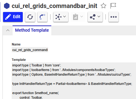

Method Templates in Release 31+ : What do you we need to know about them?
Hi community,
since a few releases Aras added a "Template" item selector to the Method ItemType.
Release 2023 already contained the new property, but didn´t use it yet. It was also hardly used in I30. But there is much more going on since I31.
What do we need to know about Method Templates?

      I just took a look at these templates (I didn't even know that this was added since I've come back and have been using the newer releases).
      From a quick glance, it seems like they really aren't intended to be interacted with that much. It seems they are limited to only TypeScript Methods, and it also seems that TypeScript Methods can't be created (at least not easily). I think we can look at these as serving a similar purpose to the Templates in the method-config.xml file that exist for C# and VB Methods where they mostly exist as a wrapper to assist in compilation.
      It could be possible that these templates are going to be expanded upon in the future, but I haven't heard anything about that so far.

        thanks for the insights! My first idea was whether we could use the template to integrate JS or TS libraries more easily.
        Luckily I right now don´t even have use case.
        But if anyone ends up testing this, feel free to share the results!
