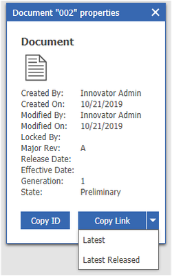

Hi! This Properties > Copy Link > Latest or Latest Released feature can be seen from Aras 11.0 SP10 instance onwards. We are however using an SP9 instance. Is there any way to use this feature on SP9? Probably as an Action menu feature, or something? On SP9, simply adding :current or :released like the ones below, doesn't seem to do the trick... http://localhost/innovatorserver/?StartItem=Document:CONFIG_ID:released http://localhost/innovatorserver/?StartItem=Document:CONFIG_ID:current5.1KViews0likes2CommentsCannot insert the value NULL into column 'NAME',
