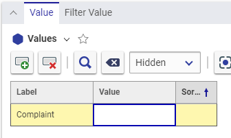

  • And, then when making lists it would be great if the value auto-magically matched the visual! Too funny.

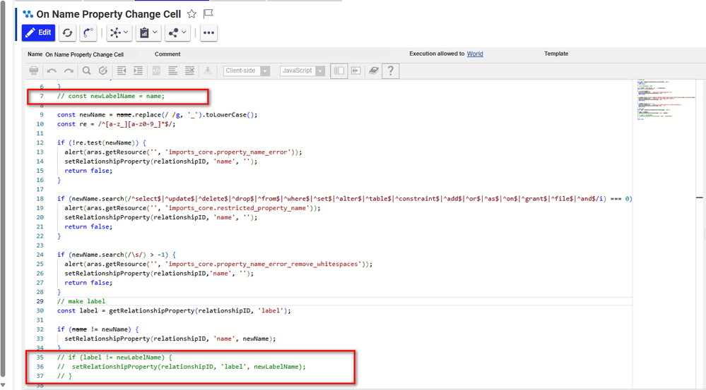

  • This is my solution: don't allow autofill label. Change "On Name Property Change Cell" method.
