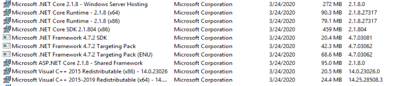

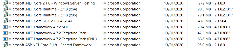

      I am getting the same problem as the OP. Originally it was the 500 Error, however after installing the correct version of ASP.NET Runtime Core (Hosting) it then changed to the 502 Error.
      I believe I have installed the correct versions of all the relevant software;
      It is a new install on a Windows Server 2019 and SQL Server 2017 machine, which I realise is outside the normal specs.
      Any ideas on how to debug this further, or anything else to try?
