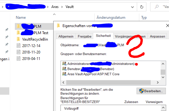

I want to delete some orphaned files in the File Vault. We don´t use the "delete automatically" variable. I am able to discover the affected files in the file vault.

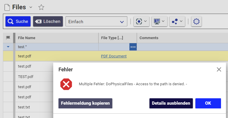

But when I try to delete one orphaned file manually in the File ItemType I get the following error message:
Multiple Errors: DoPhysicalFiles - Access to the path is denied. -
I assume I have add an additional permission to the Vault-folder structure in the File vault. But which one shall I use?
I remember I added one additional permission in the past on my old MS Server 2012. But I didn´t use the setting on my new 2022 instance. I assume I used "IIS_USRS" or similar in the past. But I never knew if this was the "correct" permission to use.

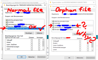

  • Some update. I compared the used folder permission of orphaned and non-orphaned files and discovered something strange.
    All regular files that are still in use contain permission for "Aras Vault AppPool .NET Core".
    But most (not all...) orphaned files doesn´t contain this permission anymore. Instead they contain a permission for a local user account. When I add the Vault AppPool permission manually, I am able to delete the file.
    Which setting can lead to this "change of permission"? I assume it´s an IIS setting, but I am not sure.

    after an eternity I finally build a PowerScript to repair the wrong permissions.
    The issue itself was trivial and caused by moving the Vault Server to a new Server instance. For previous files, the permissions weren´t set correctly and only new files used the correct Vault AppPool permission.
