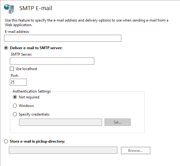

  • Hi Eli, Thanks for your reply, I follow the instructions as you said, in InnovatorServer.xml, I keep <Mail SMTPServer="queue" /> and configure the SMTP E-Mail on IIS, but now I got error: CANNOT GET IIS PICKUP DIRECTORY. I found one solution for that on this forum but in my case it won't work. Here is that solution: community.aras.com/.../ I don't found SMTP service in services list or Mailroot folder in inetpub folder. Do I need to install any 3d party SMTP Server. My machine is windows 10 so I can't find the server manager. Thanks.
  • eli_donahue's avatar
    eli_donahue
    Hi Maddy, You can try using the IIS SMTP E-mail configuration to set up the connection to your gmail SMTP server. Open up the Information Services (IIS) Manager on your server and select "SMTP E-mail" from the ASP.NET features section. You will see a form like this that you can use to enter your SMTP server address, the port you want to use, and the authorization credentials required.
