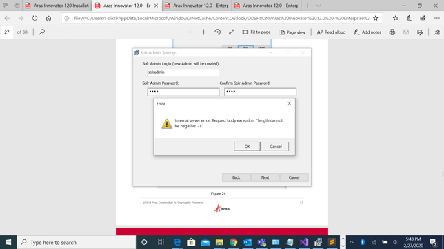

Hey,
I am following the installation guide to install the Aras Enterprise search. I have installed ZooKeepers, Cluster Service and Solr node.  While installing the agent service by running ArasESAgentSetup.msi file, it's giving an error stating "Internal server error: Request body exception: "length cannot be negative: -1". It's occurring at the Solr admin settings window.
Error Screenshot -
Any suggestions?
Thanks
  • Hi Divyak02,
    I was able to recreate this issue, did you install the January 2020 version of Open JDK 8? If so uninstall that version and download the October 2019 release instead and make sure that the JAVA_HOME variable and path variables are set correctly to point to that installation.
    Hope this helps!
    Nithin
