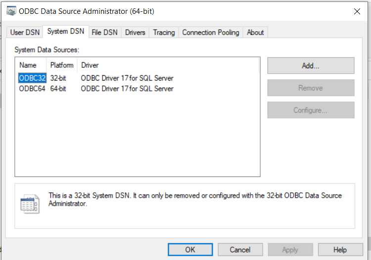

      Yes, tried setting system DSN for odbc driver manager, but it did not work. Let me try again thoroughly for setting DSN. I will revert once tested this approach.

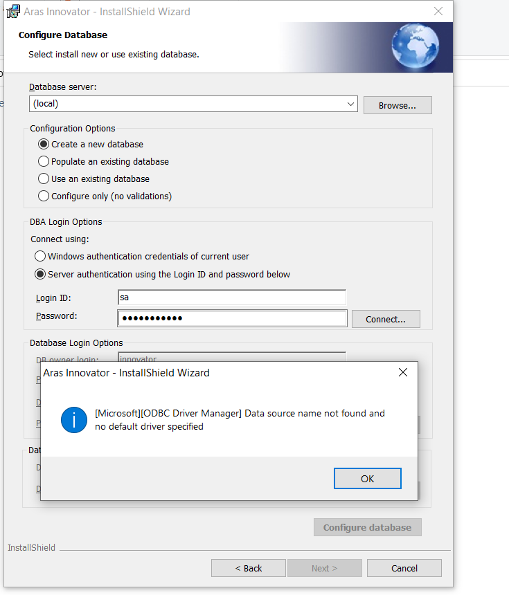

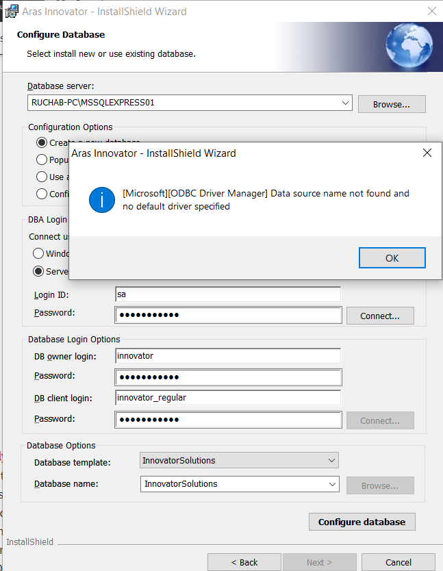

        I have added DSN for ODBC over here
        Now I am able to connect to sql with sa login, but when I click on configure database it gives the error
        Could you please suggest what to do?
