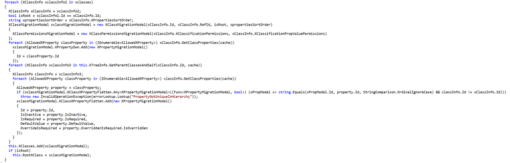

But when I try to save the xClassification tree I get this error:
I found the Error String in {Aras.Server.Core.dll}. internal class XTreeMigrationModel but, I'm not sure what it is actually doing to throw the exception. Below is the code snippet that throws the exception.
  • It looks like the Post got snipped at the end.
    So here is the code snip from Aras.Server.Core.dll.

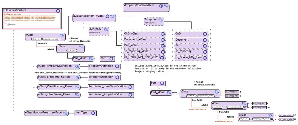

    Scott
    Also here is the data model I'm using:
