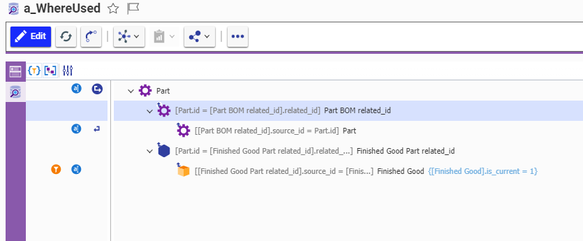

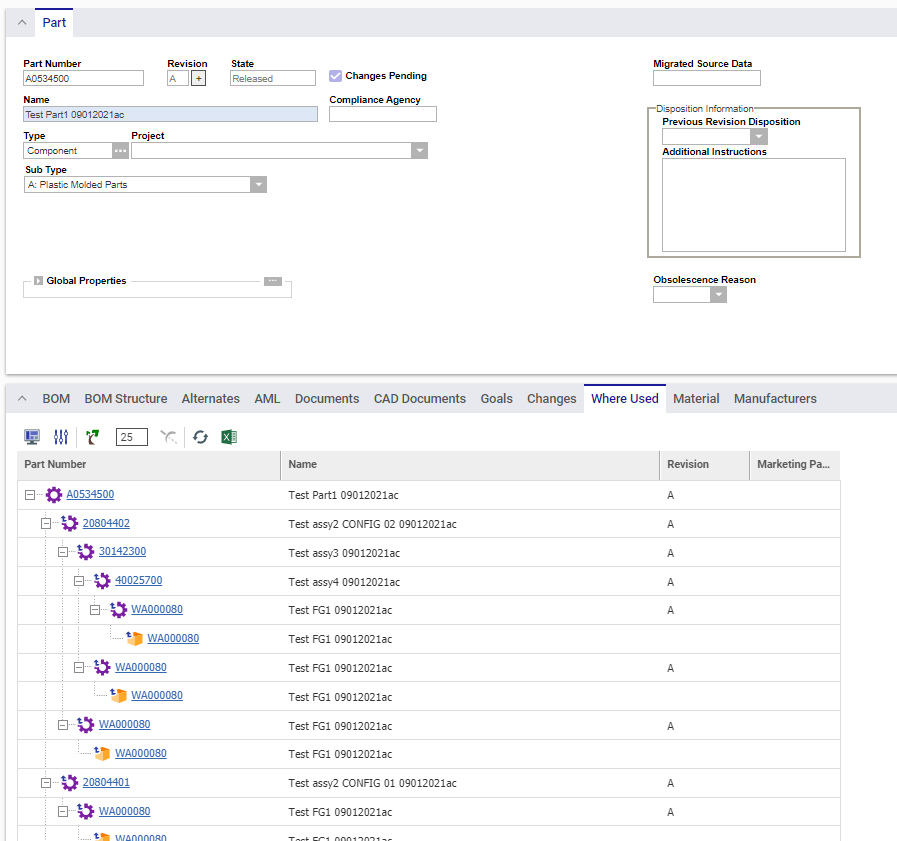

  • Per Angela's suggestion, I did this with a query definition. Basically I have a custom item type for Finished Goods that lives at the top of all my BOMs and I needed the Where Used to go all the way up to that item. I have also got the AML from this query somewhere. I simply ran the debugger to get the log to view the AML request sent to the server as the query was executed.
    My definition looks like:
    And the resulting view looks like (it's looking up even though it looks like it's going down... haven't figured this part out yet):
