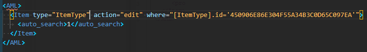

UPDATE:
I managed number 2 using root user credentials and AML post. I've confirmed and now ITypes have results right away, as desired.

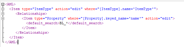

Now, if I could only identify the AML representation to update the IType -> Properties -> name "Default Search"... oh, Properties is a Relationship, right? I'll start there.

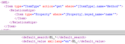

I got a hint from my Method IType, where I was able to use the GUI to define a default search that works just fine (matching a naming convention for this company "BL".

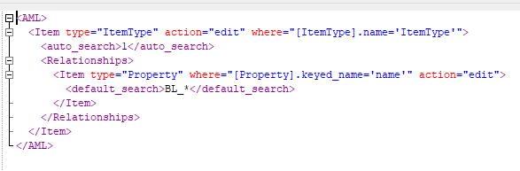

Haha! This works - but you have to be "root", not just "admin":
  • This is how:
    I do wish it were easier to share code here, but this works to do both 1&2 at the same time. BUT, YOU HAVE TO BE "ROOT", NOT "ADMIN".

  • This is how:
