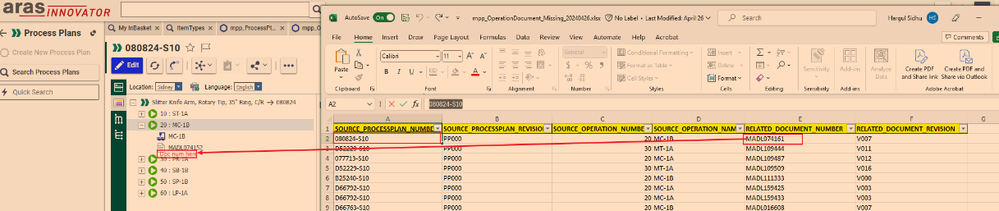

Upload missing document relationship in Process Plan. "Add" statement doesn't work
I need to upload relationship between Operation Document and the Documents.
As you can see from the picture below the hierarchy of Process Plan is:
Process Plan--> Operation Number (which is `sort_order`, in this case it is 20)-->Document
I have an excel sheet of the missing documents that need to show under an operation (20)
The document relationship cannot by uploaded just to Operation because the operation 20 will exist under other Process Plans.
However, under one process plan the operation number is unique, so in this case there will be only one operation with sort_order 20.
The documents already exist, I just need them to be shown here.

    • Hargul_Sidhu's avatar
      Hargul_Sidhu
      Thanks for replying but it doesn't work, I get sliglty different output though. Previously, the output would contain the existing document.
      Adding your snippet doesn't return mpp_operationDocument. It could be because we are editing and not "getting".
      I tried your snippet with "edit" and "update", the result is the same, no mpp_operationDocument.
      Do I need to declare <source_id>? I tried that too. I added this line
      <Item type="mpp_processPlan" action="get">
      <source_id>
      <item_number>080824-S10</item_number>
      </source_id>
      This returns mixed up data for different process plans and operations, and not specificially for 080824-S10.
      My complete code with your snippet and output is:
      code:
      [embed:dc8ab71f-3b98-42d9-b0f6-e21e02a0f8e2:d5661bf8-f89e-46d4-ac51-11ce51f71763:type=xml&text=%3CAML%3E%0A%3CItem%20type%3D%22mpp_processPlan%22%20action%3D%22get%22%3E%0A%3Citem_number%3E080824-S10%3C%2Fitem_number%3E%0A%3CRelationships%3E%0A%3CItem%20type%3D%22mpp_Operation%22%20action%3D%22get%22%3E%0A%3Csort_order%3E20%3C%2Fsort_order%3E%0A%3CRelationships%3E%0A%3CItem%20type%3D%22mpp_operationDocument%22%20action%3D%22update%22%3E%0A%3Crelated_id%3E%0A%3CItem%20type%3D%22Document%22%20action%3D%22get%22%3E%0A%3Citem_number%3EMADL074161%3C%2Fitem_number%3E%0A%3C%2FItem%3E%0A%3C%2Frelated_id%3E%0A%3C%2FItem%3E%0A%3C%2FRelationships%3E%0A%3C%2FItem%3E%0A%3C%2FRelationships%3E%0A%3C%2FItem%3E%0A%3C%2FAML%3E]
      Output: As you can see there is no mpp_operationDocument in this
       [embed:dc8ab71f-3b98-42d9-b0f6-e21e02a0f8e2:e3f5316f-e171-4b83-90ca-59d25369b80e:type=xml&text=%3CSOAP-ENV%3AEnvelope%20xmlns%3ASOAP-ENV%3D%22http%3A%2F%2Fschemas.xmlsoap.org%2Fsoap%2Fenvelope%2F%22%3E%0A%3CSOAP-ENV%3ABody%3E%0A%3CResult%3E%0A%3CItem%20type%3D%22mpp_ProcessPlan%22%20typeId%3D%224E030A4723224002B3E94F40F01AC1DE%22%20id%3D%22767F3FCDCC0F4CCF95F3CA3D9DB9D391%22%3E%0A%3Cconfig_id%20keyed_name%3D%22080824-S10%22%20type%3D%22mpp_ProcessPlan%22%3E767F3FCDCC0F4CCF95F3CA3D9DB9D391%3C%2Fconfig_id%3E%0A%3Ccreated_by_id%20keyed_name%3D%22Data%20Migration%22%20type%3D%22User%22%3E08880028FF8C43D48CB02B44EB74B127%3C%2Fcreated_by_id%3E%0A%3Ccreated_on%3E2024-02-20T11%3A49%3A02%3C%2Fcreated_on%3E%0A%3Ccurrent_state%20name%3D%22Released%22%20keyed_name%3D%22Released%22%20type%3D%22Life%20Cycle%20State%22%3E7109CDD337C84AFF87F55B21CCAC34AC%3C%2Fcurrent_state%3E%0A%3Cdescription%3E%3C%2Fdescription%3E%0A%3Cgeneration%3E1%3C%2Fgeneration%3E%0A%3Chas_change_pending%3E0%3C%2Fhas_change_pending%3E%0A%3Cid%20keyed_name%3D%22080824-S10%22%20type%3D%22mpp_ProcessPlan%22%3E767F3FCDCC0F4CCF95F3CA3D9DB9D391%3C%2Fid%3E%0A%3Cis_current%3E1%3C%2Fis_current%3E%0A%3Cis_released%3E1%3C%2Fis_released%3E%0A%3Ckeyed_name%3E080824-S10%3C%2Fkeyed_name%3E%0A%3Clocation%3E10%3C%2Flocation%3E%0A%3Cmajor_rev%3EPP000%3C%2Fmajor_rev%3E%0A%3Cmodified_on%3E2024-02-20T11%3A49%3A02%3C%2Fmodified_on%3E%0A%3Cname%3ESlitter%20Knife%20Arm%2C%20Rotary%20Tip%2C%2035%22%20Ring%2C%20C%2FR%3C%2Fname%3E%0A%3Cnew_version%3E1%3C%2Fnew_version%3E%0A%3Cnot_lockable%3E0%3C%2Fnot_lockable%3E%0A%3Cowned_by_id%20keyed_name%3D%22Mfg%20Eng%22%20type%3D%22Identity%22%3ED46B8ECBDB0C4D94BFF7A93D36FAB474%3C%2Fowned_by_id%3E%0A%3Cpermission_id%20keyed_name%3D%22Process%20Plan%20-%20Released%22%20type%3D%22Permission%22%3EE4EB045B2622409BA09AC91778FAE18C%3C%2Fpermission_id%3E%0A%3Crelease_date%3E2024-01-29T00%3A00%3A00%3C%2Frelease_date%3E%0A%3Cstate%3EReleased%3C%2Fstate%3E%0A%3Citem_number%3E080824-S10%3C%2Fitem_number%3E%0A%3Citemtype%3E4E030A4723224002B3E94F40F01AC1DE%3C%2Fitemtype%3E%0A%3CRelationships%3E%0A%3CItem%20type%3D%22mpp_Operation%22%20typeId%3D%2291B674D7C7AF47F99CA1C2FB26C38DBF%22%20id%3D%2277DD37200C7B4858833A6D6D8A48F4FA%22%3E%0A%3Cconfig_id%20keyed_name%3D%2220%22%20type%3D%22mpp_Operation%22%3E77DD37200C7B4858833A6D6D8A48F4FA%3C%2Fconfig_id%3E%0A%3Ccreated_by_id%20keyed_name%3D%22Data%20Migration%22%20type%3D%22User%22%3E08880028FF8C43D48CB02B44EB74B127%3C%2Fcreated_by_id%3E%0A%3Ccreated_on%3E2024-02-20T12%3A06%3A27%3C%2Fcreated_on%3E%0A%3Ccycle_time%3E60%3C%2Fcycle_time%3E%0A%3Cdescription%20xml%3Alang%3D%22en%22%3EMC-1B%20MC2%20CNC%20Machine%20Centre%20S10%3C%2Fdescription%3E%0A%3Cgeneration%3E1%3C%2Fgeneration%3E%0A%3Cid%20keyed_name%3D%2220%22%20type%3D%22mpp_Operation%22%3E77DD37200C7B4858833A6D6D8A48F4FA%3C%2Fid%3E%0A%3Cis_current%3E1%3C%2Fis_current%3E%0A%3Cis_released%3E0%3C%2Fis_released%3E%0A%3Ckeyed_name%3E20%3C%2Fkeyed_name%3E%0A%3Cmajor_rev%3EPP000%3C%2Fmajor_rev%3E%0A%3Cmodified_on%3E2024-02-20T12%3A06%3A27%3C%2Fmodified_on%3E%0A%3Cname%20xml%3Alang%3D%22en%22%3EMC-1B%3C%2Fname%3E%0A%3Cnew_version%3E1%3C%2Fnew_version%3E%0A%3Cnmg_erp_name%3EMC-1B%3C%2Fnmg_erp_name%3E%0A%3Cnmg_location_id%3E10%3C%2Fnmg_location_id%3E%0A%3Cnot_lockable%3E0%3C%2Fnot_lockable%3E%0A%3Cpermission_id%20keyed_name%3D%22Process%20Plan%20-%20Released%22%20type%3D%22Permission%22%3EE4EB045B2622409BA09AC91778FAE18C%3C%2Fpermission_id%3E%0A%3Csetup_time%3E0%3C%2Fsetup_time%3E%0A%3Csource_id%20keyed_name%3D%22080824-S10%22%20type%3D%22mpp_ProcessPlan%22%3E767F3FCDCC0F4CCF95F3CA3D9DB9D391%3C%2Fsource_id%3E%0A%3Cwi_details%20xml%3Alang%3D%22en%22%3E%3C%2Fwi_details%3E%0A%3Csort_order%3E20%3C%2Fsort_order%3E%0A%3C%2FItem%3E%0A%3C%2FRelationships%3E%0A%3C%2FItem%3E%0A%3C%2FResult%3E%0A%3C%2FSOAP-ENV%3ABody%3E%0A%3C%2FSOAP-ENV%3AEnvelope%3E%0A]
        Ah I see. There are two options.
        The most reliable way is to edit the complete chain (edit ProcessPlan, edit Operation, edit DocRelationship with a Document you get). For editing an item, you also need to use "where" to specify which element you want to edit.
        [embed:dc8ab71f-3b98-42d9-b0f6-e21e02a0f8e2:7b6abc98-a21a-4eb3-b111-74e4dee04e6b:type=xml&text=%3CAML%3E%0A%3CItem%20type%3D%22mpp_processPlan%22%20action%3D%22edit%22%20where%3D%22%5Bmpp_processPlan%5D.item_number%3D%27123%27%22%3E%0A%3CRelationships%3E%0A%3CItem%20type%3D%22mpp_Operation%22%20action%3D%22edit%22%3E%0A%3Csort_order%3E20%3C%2Fsort_order%3E%0A%3CRelationships%3E%0A%3CItem%20type%3D%22mpp_operationDocument%22%20action%3D%22edit%22%3E%0A%3Crelated_id%3E%0A%3CItem%20type%3D%22Document%22%20action%3D%22get%22%3E%0A%3Citem_number%3EMADL074161%3C%2Fitem_number%3E%0A%3C%2FItem%3E%0A%3C%2Frelated_id%3E%0A%3C%2FItem%3E%0A%3C%2FRelationships%3E%0A%3C%2FItem%3E%0A%3C%2FRelationships%3E%0A%3C%2FItem%3E%0A%3C%2FAML%3E]
        Or you just edit the relationship itself with source_id and related_id. An AML query without the parent levels of the chain would work, but have to know the source_id or get it based on the Operation (which is probably not a unique item). I personally would use the first option.
