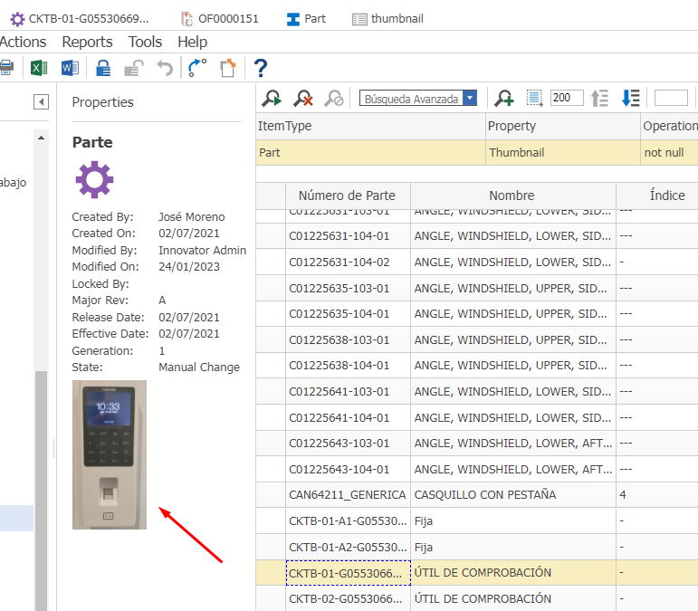

      Good morning Angela, too many thanks. yes, sorry, in the sidebar.
      I see the IntemType "PART" that have this "thumbnail" and i make the same in the ItmType "AIT Production Order'.With the same name/properties:
      ItemType "PART", it works fine.
      ItemType "PART" properties. It works fine.
      ItemType "AIT Production Order", i make the same, with the same properties. it dont wworks.
      Only, the difference is that this "thumbnail is a foreing from the order Itemtype. But it works fine the "Views", but not in the sidebar.
