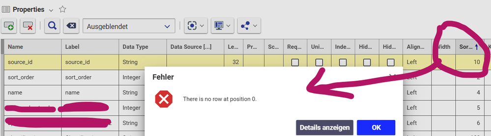

does anyone what can cause this error message when editing item properties? -> "There is no row at position 0."
I have a carrier ItemType used for Federation were I use a couple of custom properties. One is a "source_id" look-a-like property. But it´s not the original one from a relationship ItemType.
Anyway - when I change the sort_order of the source_id property, I get the shown error message.
In the past I have seen the error message randomly for all kind of system properties. It´s a error that is typically thrown by SQL. I sometimes get the error message when changing the sort_order setting, but not always. It´s pretty random.
Does anyone know more?

      Hi Eli,
      for my use case the "item" datatype would work too. Choosing "string" as data type was just some precaution to avoid any connection that is not really there. But when I change data type to "item" I get the same error message.
      This only affects my "fake" source_id property. I can´t even rename it, but luckily Innovator allows me to remove it.
      If I use a new property "fed_source_id", everything works fine, so I go with this solution. Thanks for the fast help!
      EDIT: I think I found the reason for this behavior!
      Real "Source_id" properties typically come with an SQL index. But my fake property doesn't have any cause it wasn't created by Innovator in the context of a "real" relationship.
      So the error is not thrown by updating the property itself (cause why should Innovator care for the sort_order?), but by Innovator trying to update the surrounding SQL elements, especially the Index. The error message itself wasn't thrown by Innovator, but by the SQL database that failed to do the update of not existing elements.
