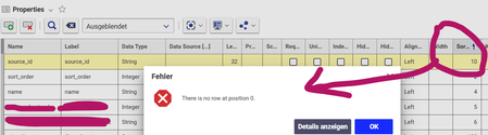

Hi community,
does anyone what can cause this error message when editing item properties? -> "There is no row at position 0."
I have a carrier ItemType used for Federation were I use a cou...

Hi Angela,
I haven’t tested to confirm, but I suspect that the issue is related to the fact that the source_id property data type is string rather than item.
It’s ok to configure the labels, sort order, etc. for system properties, but I do not recommend changing how they fundamentally work (ex: deleting, renaming, changing data types). This can cause unexpected behavior and break core capabilities.
Could you instead use a custom property like “fed_source_id” to manage the data in this use case?
