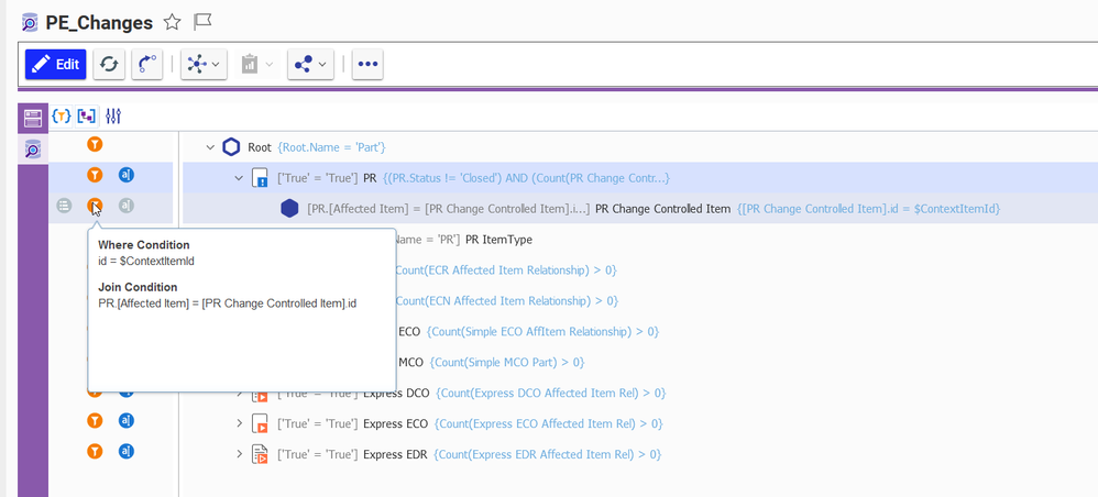

    So the Changes tab on part utilizes a Tree Grid View/ Query Definition called PE_Changes. You should be able to instert deviations into the QD just like the other itemypes you see in the query:
    Let me know if you have further questions once you start implementing!
    • AJ,
      Thanks for the quick reply. Can you give me a pointer on how to add Deviation to the QD? I think I had seen this PE_Changes previously, but couldn't figure out how to add another row properly.
      I right-click "Root" and "Add Related Item", but none of the three options seem to let me replicate the sort of selections that are in the other rows.
      Thanks!
