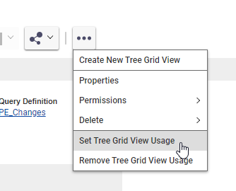

Once you've created a new QD and TGV, you will go to the TGV form and run the following action:
Here you can set a relationship view and it will automatically add a new relationship to the part Item which shows off your TGV.
