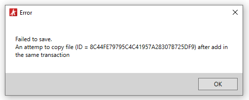

2. When set to OnAfterUpdate or OnAfterAdd I get an error when saving via the office connector, of note, OnAfterUpdate works fine when making an edit to the form, at that point the filename does get updated correctly:

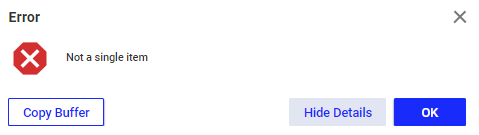

4. When set to OnBeforePromote/OnAfterPromote/OnBeforeAdd:
Help...

      I only want to use one event type if possible. We are using the connector, however I attempted each type due to the fact that none of them were able to complete the task without issue. The closest and most ideal would be OnAfterUpdate however the office connector throws the error.
