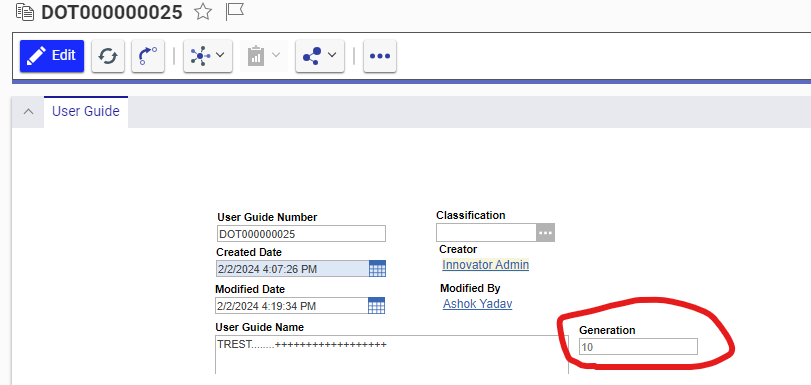

Hi All,
I have question related to Edit version able Item.
Let suppose . I want to edit Item Type user Guide. User Guide Number is Doc*25
and Generation 10.

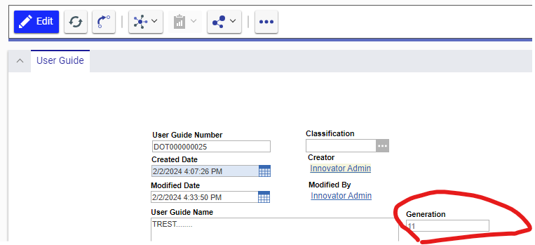

I logged with user  X and edit User Guide Number  Doc*25 next and Generation 11 has been created.
Note : I do not want to close User guide Item Type with Generation 11.

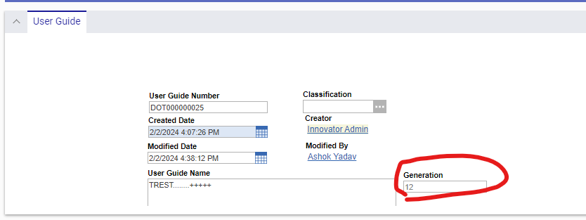

After some time User Y logged in  innovator Modified user guide of Generation 11.
After edit user guide by User Y  Generation become 12.
And after That User X already keep Open Generation  11 of User guide.
User X modified Generation  11 of User guide.
And then what  happened All change done  Generation 12 by user Y has been losses after modified by user X of Generation 11.
How to handle this situation by Configuration ?
Regards
Ashok Kumar Yadav

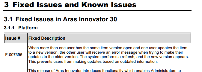

        For general informatoin. Aras patched it in Release 30
