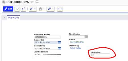

Hi All, I have question related to Edit version able Item. Let suppose . I want to edit Item Type user Guide. User Guide Number is Doc*25 and Generation 10. I logged with user  X and e...

    I am using  Aras Innovator 12 SP 9.
    I created On server side(onBeforeVersion Event) method to deal with this situation .
    Innovator inn=this.getInnovator();
    string is_current=this.getProperty("is_current");
    if(string.Equals(is_current,"1"))
    else{
    return inn.newError("You can not modify old Generation of Part.Please refresh Or Close and open again Part");
    return this;
