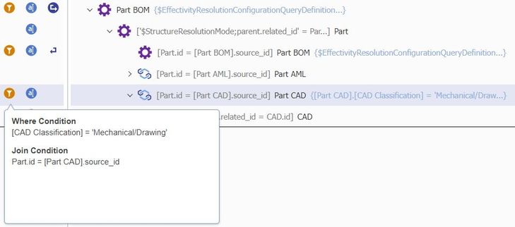

Hello all. I am adding more information to the 'BOM Structure' tgv query and could use some help in removing duplicate rows. Although I know various ways of handling this in SQL, I have not been able to arrive at a solution using where or join conditions in this Query Definition.
In this case, I want to display a link to the items CAD drawing viewable. The below query outputs the correct results (using a foreign CAD classification property) however there are occasions where the Part CAD relationship may have been been accidentally created twice. Ideally, I would only return the first row.
Here is a screenshot of the query definition:

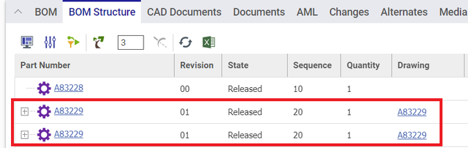

Here is what the output looks like:

    did you find a solution? I haven´t seen this one in my Innovator yet. The simplest reason would be, that the there are two references of the CAD file to the part (relationship + property item?). Another variant is maybe that all CAD versions are referenced, not just the latest one. Maybe you have multiple generations of these items?

      For us, this happens because someone has accidentally added a duplicate Part CAD relationship. We try to clean those up as we see them, but if the BOM Structure query happens to find a duplicate then we would always prefer that only one is returned. I have not yet found a solution.

        Hello,relationship item has grid event "onInsettRow",you could filter repeat relationship in this event.
