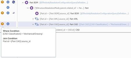

did you find a solution? I haven´t seen this one in my Innovator yet. The simplest reason would be, that the there are two references of the CAD file to the part (relationship + property item?). Another variant is maybe that all CAD versions are referenced, not just the latest one. Maybe you have multiple generations of these items?
- Don_Jackson2 years agoIdeator II
For us, this happens because someone has accidentally added a duplicate Part CAD relationship. We try to clean those up as we see them, but if the BOM Structure query happens to find a duplicate then we would always prefer that only one is returned. I have not yet found a solution.
- taozai2 years agoIdeator II
Hello,relationship item has grid event "onInsettRow",you could filter repeat relationship in this event.
Relationship grid events seem very useful, I'll look into them more. Thank you!
