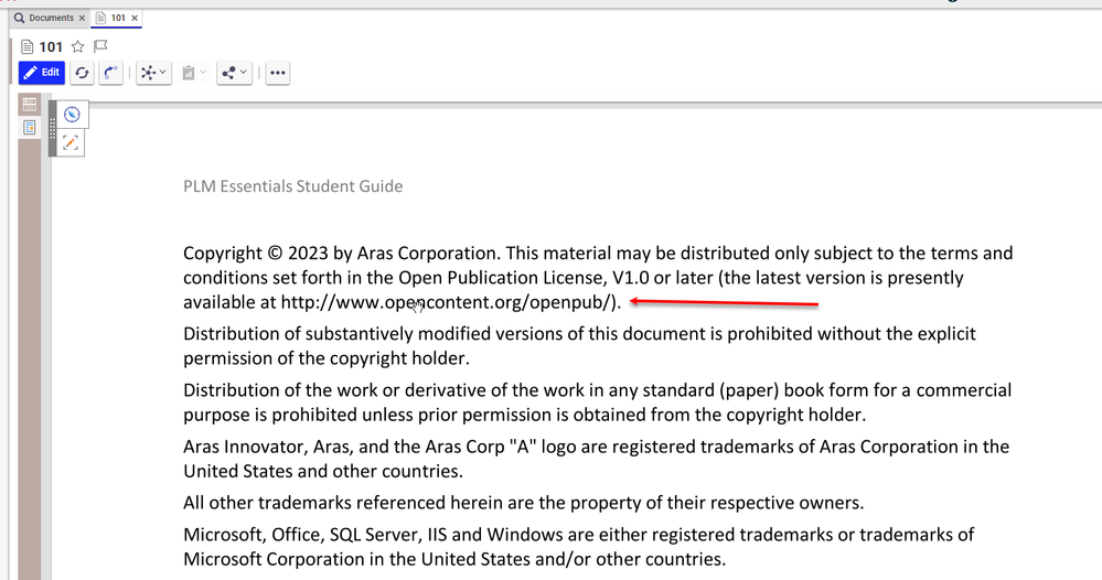

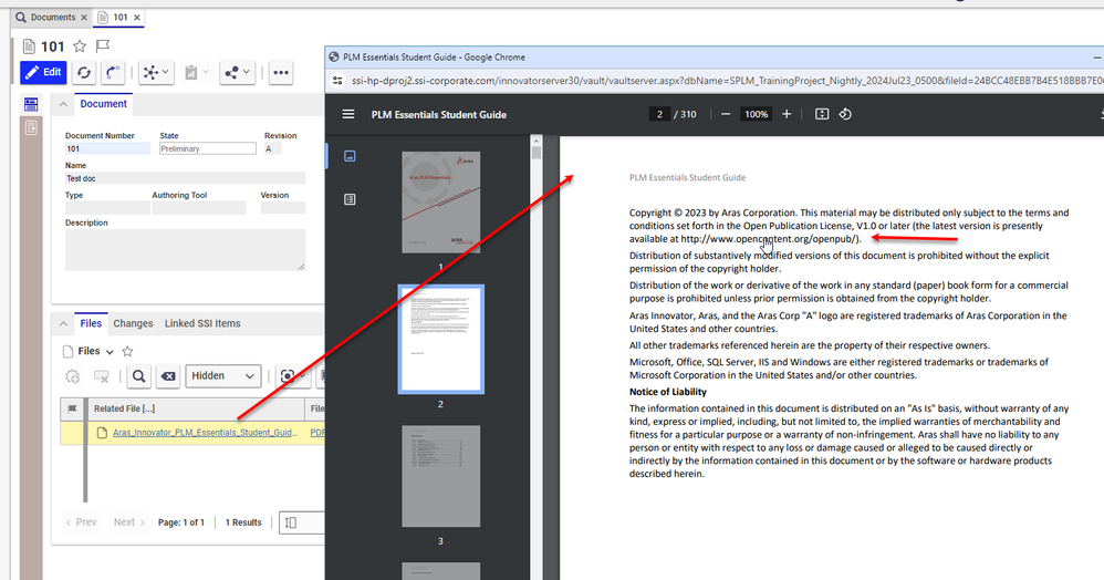

It looks like a PDF opened in the PDF Viewer doesn't support clickable links in the text, that are clickable when the PDF is opened directly in Adobe, or opened in a new browser window off the Files tab. Is that other people's experience? Thanks
Screenshot of using PDF Viewer, link is not clickable
Open the PDF from the Files tab, opening a new browser window and I guess Adobe within the browser, the link is clickable
  • An update. I've had a back and forth with Aras Support. They have done some investigating and clickable links should work in PDF Viewer and do usually work.
    The example I shared above, in a PDF that Aras produced (the Essentials training guide), is an exception. They don't understand why that one doesn't work, other links in the same document do work as expected. Seems I was just (un)lucky using that PDF when I wanted to try it out.
    So links should work.
