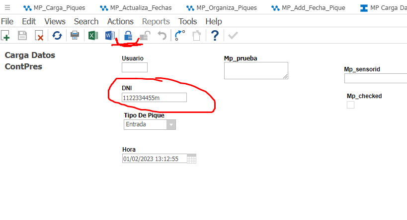

Hello, I would like to pass a value to a field of an itemtype by code. I have put it in the "onBlur" event of another field

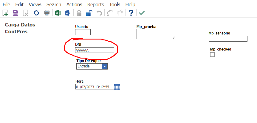

The case is that I pass the value and it shows it on the screen, but when I click on save (lock), it deletes the data.
What am I doing wrong?
My code:
var input = getFieldByName("mp_dni");
input.getElementsByTagName("input")[0].value = "AAAAAAAAAA";
After passing the value to it:
when i lock:
Too many thanks!!!.
  • You code just change the visible value in the form, but doesn´t update the property in the DOM.
    Try to use something like this: window.handleItemChange("myproperty", "123");
