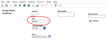

Pass values from Method to form fields
Hello, I would like to pass a value to a field of an itemtype by code. I have put it in the "onBlur" event of another field The case is that I pass the value and it shows it on the screen, but when ...
null
    3 years ago
    You code just change the visible value in the form, but doesn´t update the property in the DOM.
    Try to use something like this: window.handleItemChange("myproperty", "123");
