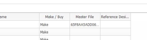

I added a new field in my "Part" item type that's is called "master file" which is an item type that comes from the FILE item type. I changed the PartLevel BOM code so it displays in the BOM Structure. My two issues are:
1. How can I display the keyed name for that file instead of the ID. I changed the GetMultiBom method from:
infoOfItem.file_master = itm.getProperty("related_file_master", "");
to
infoOfItem.file_master = itm.getPropertyAttribute("related_file_master","keyed_name","");
but that didn't work.
2. How can I make that field act like a item type field so it's clickable to display that item? It's only displaying the ID number and I'm not able to click the ID to display that file. - see attachment.

    Is it in BOM structure tab or in report? Check keyed_name Order is set for the file item type.
    Which version of ARAS you are using. later version use query definition to display the bom structure and it is easy to give the reference link

      Hi Gopikrishnan
      1. It's in the BOM structure tab. The keyed_name order is set to "filename". I'm not sure why it's not working.
      2. I'm using version 11.11
