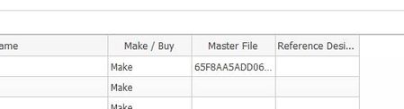

1. How can I display the keyed name for that file instead of the ID. I changed the GetMultiBom method from:
Is it in BOM structure tab or in report? Check keyed_name Order is set for the file item type.
2. How can I make that field act like a item type field so it's clickable to display that item? It's only displaying the ID number and I'm not able to click the ID to display that file. - see attachment.
Which version of ARAS you are using. later version use query definition to display the bom structure and it is easy to give the reference link
