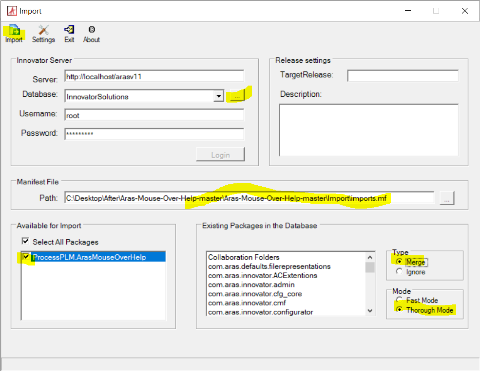

        Hi Nathan
        Follow below steps
        Download the package from https://github.com/ProcessPLM/Aras-Mouse-Over-Help
        Download the Import/Export Utilities from https://www.aras.com/en/support/downloads
        Unzip and navigate to \PackageImportExportUtilities.zip\PackageImportExportUtilities\Import folder and run import.exe
        Provide servername, database,username, password and click login
        In Path select imports.mf file from mouse over help package
        Select the available package and select type = Merge and Mode = Thorough Mode
        Click Import
        Login to application and fill help text in item type and add this method in corresponding form on populated event.
        If it does not work, confirm your aras version

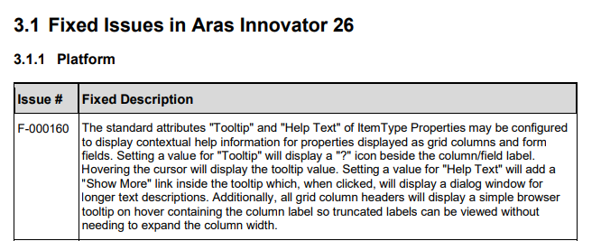

  • Hi community,
    I am not familiar with the mentioned github project and cannot help with the shown error message.
    But: Aras has integrated this feature in Innovator 26!
    Of course this is right now a subscriber-only service pack, so free-users still have to wait.
    I personally use a simple onLoad Method for adding tooltips and placeholders. It does the job.
    But I like the new Aras variant with the "?" and "Show more" options. Offers a lot of potential to integrate as much helpful information as possible.
