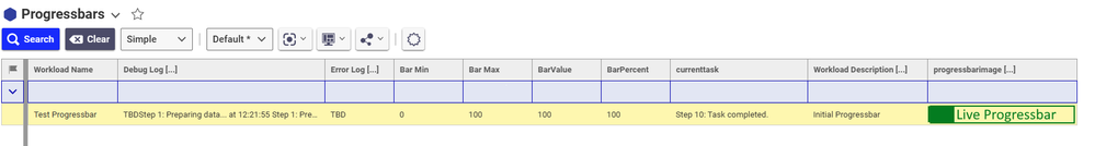

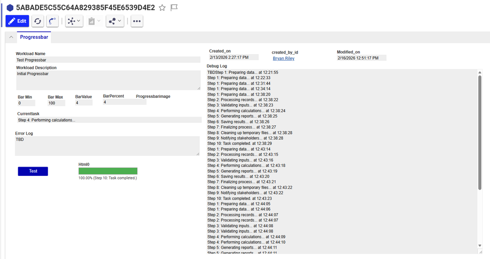

In Aras, we have a lot of different automations running at any given time, and there is no clean way (I know of) to see them all in one place. Further, I don't have access to the server, so I can't access the log files you might typically see so I'm looking for a way to write those directly into Aras.
So I set out to address these issues, by creating an ItemType called Progressbar with fields for tracking progress and on the form I created a html object and a button to trigger a 'ProgressBarClient' Method, which repeatedly calls a 'ProgressBarServer' Method multiple times.
This gets me an interface to see the status of the processing...
So before I spend too much time on this, I thought I'd see if the community has any ideas on better ways to approach this or ideas for improvement.
Some thoughts:
  • Using the button on the item probably wasn't the best move, it stops processing if you close the item. It also gave me a lot of headaches getting the typing right
  • I should probably set it up so the C# method doesn't require a return to update the progress
  • I was hoping for a live progressbar in the search grid... but using the html on the form isn't going to work because its not a property

4 Replies
  • Hi Bryan,
    That is a very cool idea, thank you for sharing. Like angela​ said: it has been a while since we saw these hands-on features.
    An idea: maybe you could host an external IOM .NET Core API end-point with streaming (like websockets) that creates a realtime status stream to your HTML page? It might be a more ligthweight solution compared to polling every interval with server methods (and even faster or more real time!).
    On another topic: are you also attending ACE Miami?
    Thanks again,
    Daan
  • Many thanks for the post! We haven’t had these kinds of experimental projects in this forum for years!
    Here is a collection of random thoughts I have regarding the idea:
    • According to your C# sample, you simulate a long-running C# method. However, I assume it is not actually running asynchronously in the background. Can this work for a ProgressBar for Server Methods?
    • A classic approach for long-running server tasks in Aras Innovator is to use the Conversion Server to execute them in the background.
    • Once I wrote something in this forum suggesting that newer Innovator versions seem to support async server methods. Right now, however, I’m having some trouble finding my previous post and the source that led me to this conclusion… 💀
    • You include extensive error handling - love to see this!'
    • Outdated code: fieldContainerEl = top.document.getElementsByName(propName)[0]; → Remove "top". We no longer use top references in 2026.
    Progress bar ideas
    • Idea #1: Use a string property with a percentage value (e.g., "20%"). Color the background according to the percentage. With CSS, you can style the background so that it visually behaves like a growing bar.
    • Idea #2: Use an SSRS or Power BI report with a data bar. If it´s just an admin view that is not needed on a daily basis....
    • Idea #3: Use an Images property. Store many images representing 10%, 20%, … 100% in your code tree. So you just update the image to "update" the progress bar. Customize the stylesheet in the codetree to make this specific image property larger. Yes, I have tried something like this before. A lot of work to get the stylesheet right..... :D.
    • bryan-riley's avatar
      bryan-riley
      Thanks! I've continued working on this project, and am successfully using it as a progressbar & logging mechanism for one of our server methods.
       I moved the trigger to an action on a part, that javascript method creates the progressbar item and passes any required information (part ID, etc) to the progressbar item, and onload of the form it triggers the second javascript method which 'initializes' the process and then repeatedly calls the server method to do the processing. So a 3-method system... trigger, controller, server
      This appears to have the benefit of giving the server a break so it doesn't bog down, and I introduced a timer to all me to adjust that spacing between calls... and I can also put debugging information into the console if I like
      Using the conversion server is a good idea too, how do you tell Aras what server to process a method on?
      I was also wondering about the Async methods, I'm guessing its there (C# supports it), but I haven't tried it.   but it doesn't solve my logging needs.
      It also goes very slow if its 1 by 1 part on a large BOM (too much updating) so now it can call the server method in 'chunks' , ex it processes 100 parts in a BOM at a time... but the progressbar is going in chunks too so I'm trying to figure out how to balance the visual with the performance.
      The CSS idea is fantastic! I'll try it this week and let you know how it goes (I'm not great with the HTML / CSS world). Where did you put the '.state...' code into Aras? Images was my backup plan, I could probably make .jpg of the bar at 1% increments and change it and it would update on a refresh? maybe not that much better than the % number I already have...
      Quick test with using custom CSS in a random "state" property:
      .state{background: linear-gradient(to right,#4caf50 0%,#4caf50 20%,#ddd 20%,#ddd 100% );}
