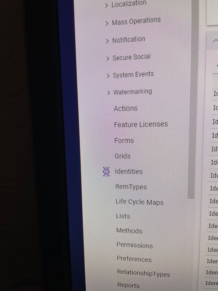

I built 5new item types and once built I realized all the icons on TOC cannot be seen anymore, don’t know why. When I logged in as a user they show up correctly. They are only not showing up when I login as innovator admin.

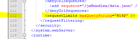

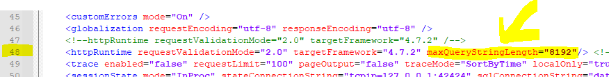

  • Hi,
    that´s a known Issue in Innovator 12 when you have to many ItemTypes in the TOC. So the bug typically affects admin.
    You can fix this one in the codetree.
    1. Open file ..Innovator\Client\web.config.
    2. Add maxQueryString attribute at two position (compare with lines numbers)
    3. Increase filesRevision counter:
    • Marklane's avatar
      Marklane
      I just try that but I still not able to find the icons.

      Thank you for this fix angela . Even though the web.config is much smaller in Version 26, it still works by simply adding the line once after the denyUrlSequences node.
