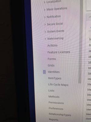

that´s a known Issue in Innovator 12 when you have to many ItemTypes in the TOC. So the bug typically affects admin.
You can fix this one in the codetree.
1. Open file ..Innovator\Client\web.config.
2. Add maxQueryString attribute at two position (compare with lines numbers)
3. Increase filesRevision counter:
Marklane
4 years agoIdeator I
I just try that but I still not able to find the icons.
