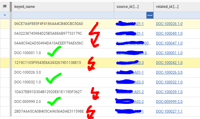

Problem: In my case the keyed_name is not set reliable. When user add Documents to Parts, the keyed_name property isn´t set to the correct Document item_number. Most of the time the Document id is used.
But soometimes the keyed_name is set correct. But I so far haven´t figured out the reason.
When I take a look at Relationship ItemType "MyPartDoc", I get a list where both variants are used in a obscure mix:
So sometimes the keyed_name seems to be set correct.
In my Innovator 12SP7 the former Action to rebuild the keyed_name is no longer available. And the keyed_names are not updated when I save the ItemType.

      Hmm.. But after I EDIT exisiting relationship
      [embed:dc8ab71f-3b98-42d9-b0f6-e21e02a0f8e2:4fa33a36-620e-430b-a6f9-6089f3468b6d:type=xml&text=%3CItem%20type%3D%27Part%27%20action%3D%27update%27%20id%3D%27AAA...AAA%27%3E%0D%0A%20%20%3CRelationships%3E%0D%0A%20%20%20%20%3CItem%20action%3D%27edit%27%20type%3D%27MyPartDoc%27%3E%0D%0A%20%20%20%20%20%20%20%3Crelated_id%3EDDD...DDD%3C%2Frelated_id%3E%0D%0A%20%20%20%20%3C%2FItem%3E%0D%0A%20%20%3C%2FRelationships%3E%0D%0A%3C%2FItem%3E]
      the keyed_name became correct.
      I don't know how useful this information is, but for some reason that's how it works
  • Wow! Many thanks for taking the time to do such detailed tests![emoticon:6d505171faa4497c85c5ca27290c555d][emoticon:1435ff2429184e17bc948e4f19178e1e]
    Quote: "But after I EDIT exisiting relationship the keyed_name became correct."
    That´s an important hint that I haven´t noticed yet. This explains the mix of correct and wrong keyed_names in my list!!!!!
    I can confirm that when adding a relationship, the "id" is used as keyed_name. When I then edit the relationship the "item_number" is used keyed_name.
    This keyed_name behavior just seems to affected relationship ItemTypes, not the normal ItemTypes. That´s one of the typical evil details of Innovator that can drive an admin crazy.

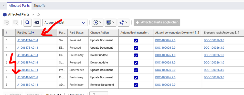

        Edit: Now I am mentally ready for the upcoming holiday season. Cause even with correct keyed_name I would never have solved my sorting problem.
        Basically I automatically create a custom DCO from a Document. When creating a new DCO it look up all Parts that use the Document and adds them to a relationship tab in the DCO. Users then shall decide if they want to update the Documents in the Part or not.
        Notice what I do here? I want to order the Parts, not the Documents. The Document keyed_name is completely useless for this use case. I was so focused on less important details that I didn´t notice my embarrassing mistake.
        So Foreign property will properly work, but I need to use it for the source_id...
