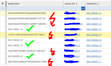

No, I was wrong. I tested and in both cases the keyed_name is set to id.
- alaxala3 years agoCreator III
Hmm.. But after I EDIT exisiting relationship
[embed:dc8ab71f-3b98-42d9-b0f6-e21e02a0f8e2:4fa33a36-620e-430b-a6f9-6089f3468b6d:type=xml&text=%3CItem%20type%3D%27Part%27%20action%3D%27update%27%20id%3D%27AAA...AAA%27%3E%0D%0A%20%20%3CRelationships%3E%0D%0A%20%20%20%20%3CItem%20action%3D%27edit%27%20type%3D%27MyPartDoc%27%3E%0D%0A%20%20%20%20%20%20%20%3Crelated_id%3EDDD...DDD%3C%2Frelated_id%3E%0D%0A%20%20%20%20%3C%2FItem%3E%0D%0A%20%20%3C%2FRelationships%3E%0D%0A%3C%2FItem%3E]
the keyed_name became correct.
I don't know how useful this information is, but for some reason that's how it works
