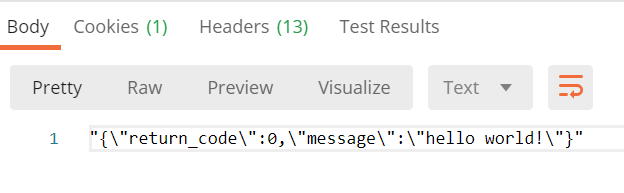

      If my method is like this:
      return this.getInnovator().newResult(new Newtonsoft.Json.Linq.JObject
      {"return_code", 0} ,
      {"message", "hello world!"}
      }.ToString(Newtonsoft.Json.Formatting.None));
      The output is a text:

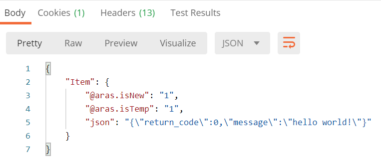

      var item = this.getInnovator().newItem();
      item.setProperty("json", new Newtonsoft.Json.Linq.JObject
      return item;
      So, you are right, with your solution the output is well a JSON.
      But a JSON of an Item. Is it possible to send a fully customized JSON ?
      Regards.
        Hi Miraks,
        standard Aras Method just can return items. "Results" and "Error" are also just items.
        Maybe you can use some kind of custom class or other more native C# techniques, but I am not sure. Some times you see these kind of designs in native Aras code.
