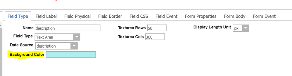

  • In case if your question is about the search result shows some color in background, check the particular field type background color in form
    Thanks
