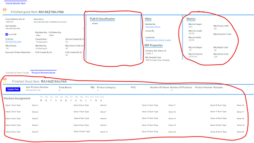

My current project has a requirement that a I have a tab, for "Finished Goods", that translates the a "Product Model Code" as a Product Nomenclature.
This "Product Model Code" contains details that will be used to validate the components of the BOM.

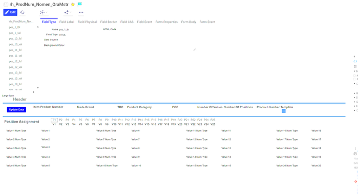

I have created a configured Form that will be used, as on a no related Relationship, for all "Finished Goods". It is to contain the derived "Product Nomenclature" properties.
The Relationship TAB "Product Nomenclature" will be visible only for "Finished Goods".
How do I populate the configured Form presented on the Relationship tab with the instance data on the relationship itemtype. I have tried top.aras.uiShowItem but that creates a tab on the main form and not in the relationship frame.

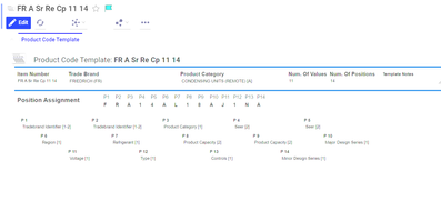

      1) Give the user a derived translation of the clients Product Number (Model Number) to create a [Product Nomenclature].
           a) The user can validate, by clicking on the TAB, that the design metrics (xClass Properties, Finished Good Properties) aligns with the metrics specified by the Product Number
           b) The Product Number presentation a codified representation of (Trade Brand, Product Category, Seer, Capacity, Voltage, Region, etc.

      5) The Derivation of the [Product Nomenclature] values will be based of the use of a mask or Template based on Trade Brand, Product Category, Product Number string length (and potentially others).
      6) An Update of the [Product Nomenclature] will be prompted by the system if the Product Number changes or its change is detected.

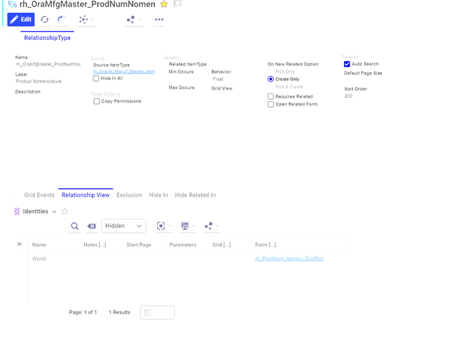

      7) The [Product Nomenclature] form is assigned as a View form the relationship Itemtype
      8) The Form is rendered via the Relationship Type --> Relationship View --> Forms configuration
      9) Currently all form updates are managed by javascript.
      10) Any persistence is accomplished via javascript
      11) Initial Form loading is done via a Form Events 'Onload' and 'OnFormPopulated' Where "this" is of type 'Window' so full form management methods.
      12) The complication is [Update Data] button where "this' is of type 'Input' and form management methods are not available
      13) Properties set are set on the item which is the Parent item and not the Relationship Item.
      14) I tried aras.uiShowItem and it only renders the form in the main Iframe and not the relationship Iframe.

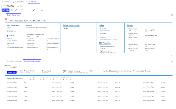

        Right now I just took a short glimpse at your new post. It seems to be a cool use case, I will try to understand it later :)
        But this sentence caught my eye:
        "I tried aras.uiShowItem and it only renders the form in the main Iframe and not the relationship Iframe."
        Do you know about  uiShowItemEx ?? The Ex versions of these functions normally includes relationships!
