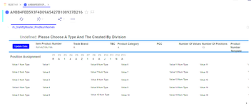

Here is the use model of the form.
The form will have key purposes:
1) Give the user a derived translation of the clients Product Number (Model Number) to create a [Product Nomenclature].
a) The user can validate, by clicking on the TAB, that the design metrics (xClass Properties, Finished Good Properties) aligns with the metrics specified by the Product Number
b) The Product Number presentation a codified representation of (Trade Brand, Product Category, Seer, Capacity, Voltage, Region, etc.
2) The Product Number metrics will be combined with the xClass and Finished Metrics to be used to validate the components (parts) in the eBOM.
Key Characteristics:
1) The [Product Nomenclature] values will be persisted on a Relationship.
2) There is only 1 relationship per Finished Good.
3) The Grid is not rendered.
4) Only Finished Goods will have access to the [Product Nomenclature]
5) The Derivation of the [Product Nomenclature] values will be based of the use of a mask or Template based on Trade Brand, Product Category, Product Number string length (and potentially others).
6) An Update of the [Product Nomenclature] will be prompted by the system if the Product Number changes or its change is detected.
7) The [Product Nomenclature] form is assigned as a View form the relationship Itemtype
8) The Form is rendered via the Relationship Type --> Relationship View --> Forms configuration
9) Currently all form updates are managed by javascript.
10) Any persistence is accomplished via javascript
11) Initial Form loading is done via a Form Events 'Onload' and 'OnFormPopulated' Where "this" is of type 'Window' so full form management methods.
12) The complication is [Update Data] button where "this' is of type 'Input' and form management methods are not available
13) Properties set are set on the item which is the Parent item and not the Relationship Item.
14) I tried aras.uiShowItem and it only renders the form in the main Iframe and not the relationship Iframe.
15) The data is being persisted so that it does not have to be derived every time its used.
16) This will also be tied to Compliance and Variant management in the future.
Good Questions.
Thanks for taking the time.
Scott

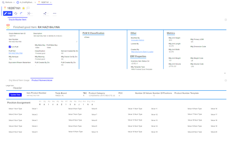

- srmorrisonearthlink-net2 years agoCreator I
Angela,
I found your post form 6 years ago and followed the guidance from Chris.
How to open a Item in a new Window instead from a Form
aras.uiShowItemEx(prodNomenItm.node,"tab view", false, false);
I got the exact same result as aras.uiShowItem().
It created a tab on the main IFrame and not on the Relationship IFrame.
The question I would have is, how does aras.uiShowItemEx know which IFrame to load the form into?
Is there some setting that would direct it?

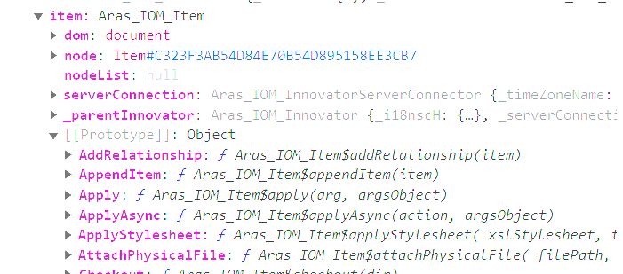

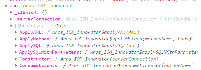

I have looked for a method under the item and inn but I don't see anything:
Thoughts?
Scott
