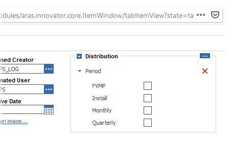

How do I create a "Method" to update an "Extended Classification" property?
I created an "Action" which has a method that reads:
this.setAction("edit");
this.setProperty("xp-monthly","1");
this.apply();
return this;
Does anyone know how to modify an "Extended Property"?

      The action is configuration is fine. It doesn't work with the "extended classification" property. If I add (this.setProperty("name","test");) to the method, the name changes to "test', but the extended property still doesn't change. I get no error messages. I'm not sure if extended classifications are handled different.  TY
