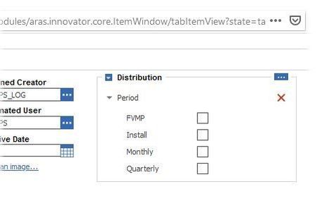

Skyler,
The action is configuration is fine. It doesn't work with the "extended classification" property. If I add (this.setProperty("name","test");) to the method, the name changes to "test', but the extended property still doesn't change. I get no error messages. I'm not sure if extended classifications are handled different. TY

I get the following error:
You tried to perform "update" operation against not defined Extended Properties:
