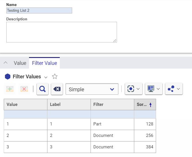

    Step 1: Navigate to Administration --> List
    Step 2: Create new list
    Step 3: Navigate to Filter Value
    Step 4: Fill your list values
    Example:
    Step 5: Create New JavaScript Method and copy below code
      Example:
