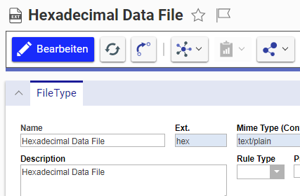

Extending the FileType table is pretty easy. We can create own entries like this:

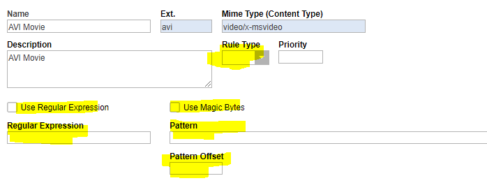

    There are also some additional properties we can specify, which might be useful. Does anyone know how to use them?
