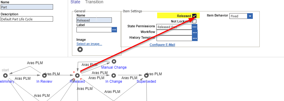

    • jeromecha's avatar
      jeromecha
      Thanks for your reply Gopikrishnan.
      In the part life cycle the Released State has  already Released checked. That's what you mean ?
